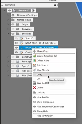

also copy command for skitch can't make copy

jeff_strater
see previous answer - same thing here.  You cannot copy/paste a sketch in a Parametric design, and have never been able to.
