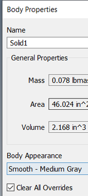

the reason why I suspect imported colors are the color names here:
that naming convention of "Opaque(R,G,B)" is what we use for the colors of imported geometry.  Some formats, such as STEP, support just basic colors, and this is what those colors look like.  For instance, here is a STEP file, exported from Fusion, and re-imported.  The blocks were originally created with native Fusion appearances, but on export/reimport, they have the same "Opaque" names.
So, even though you may not have imported much geometry, I feel pretty sure that the colors have been imported

jeff_strater
follow-up:  in the process of testing this simple case, I was able to reproduce the bug - just a round-trip through STEP reproduces it.  Created FUS-91933 to track it.
