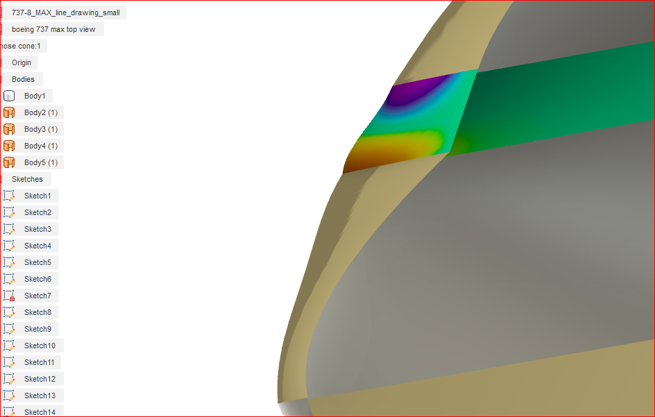

I am trying to turn a complex shell into a thickness of 5mm. I have tried everything but i cant solve it. The design has no warnings so thats propably not the problem. Is there someone who maybe could help me out.

TheCADWhisperer
@carlweitman50
Examine the Attached file...

davebYYPCU
Bottom of the window needs to be joined to the.top of the nose.
Moght help…..

davebYYPCU
I can only comment on the pics in the discussion.
If the original body was solid there is an air gap to fix,
if the outside body is as Whisperer shows, then Stitch the seam.
Might help…

Checked the file.  At 200mm diameter, you will need some windscreen detail.
Most windscreens are flat.
This wavy window is likely contributing to the failed thicken.
To assist further, need to know more of the Design Intent, 3d printed, static or flying model?

davebYYPCU
Incorporating full size details, helps with avoiding the reinvention of these details in a model.
You have horizontal window sketch lines, that are curved.
These have flat panels and are segmented.

TheCADWhisperer
@carlweitman50
Does your slicer have an option to set wall thickness
or
could you use MeshMixer to Shell a solid?
Either technique would not require a modeled Shell.
