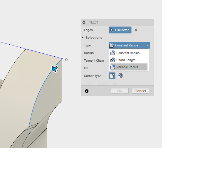

Thank you for taking the time to look into this. Actually this all came about because I couldn't find a variable fillet option - does such an option exist, and if so, how might I create one? I couldn't find a way to do it in the current fillet options.

Yes, variable Radius fillet is available in the FIllet command.  You have to change the Type dropdown to "Variable Radius" as shown in the pic below.  Note that the TYPE dropdown only appears after you select an Edge for fillet.
