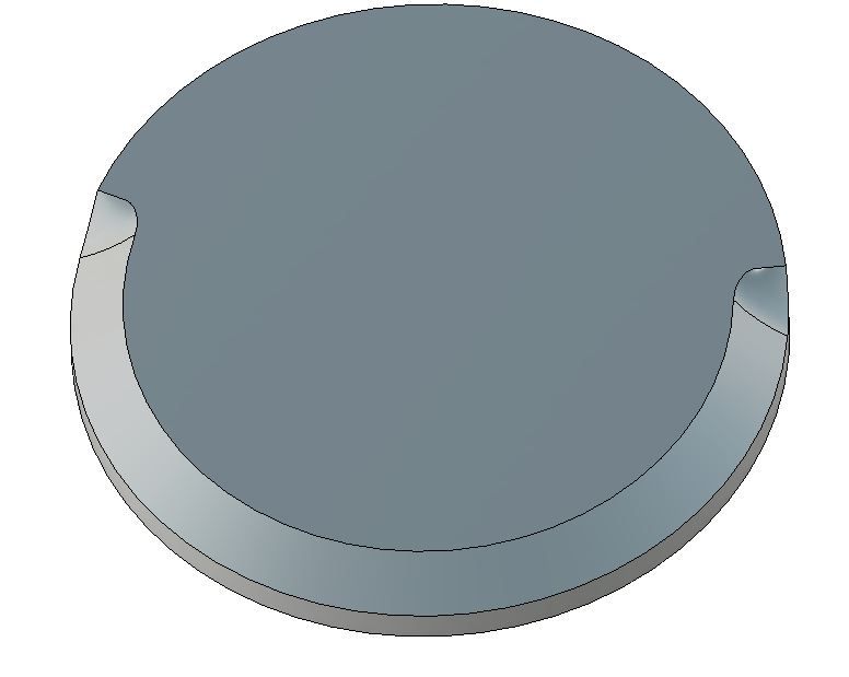

There is probably a simple answer to this one but I haven't located it.  I have a circular disk of X thickness.  I want to taper part of the edge down to a thinner Y thickness.  Neither the chamfer tool or lofting seems to work.   I included a picture with the two thickness shown as a step; I want to get rid of that step and replace it with a sloped edge.

Remove the fillets on the ends, then use a two direction chamfer.  Add fillets at the ends.

That worked!   Thank you!
