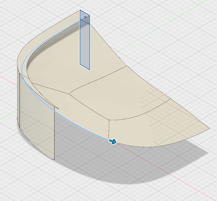

I have a T-spline plane, two corners rounded and sculpted in three dimensions, of which I want to use the 3D edge as path for a sweep. The profile to sweep is supposedly a simple rectangle, but there's material needed above the sweep path and much more below it, so I've centered a rectangle on the starting point of the T-spline edge corner and drew another tall one below it. Select both to sweep.
Problem:
Parallel mode keeps verticality okay, but does not go all the way around to completion. And worse, it keeps the profile (rectangles) parallel to the sketch plane, which is not what I want.
Perpendicular mode oddly angles the sweep inward below the T-spline, which again is not what I want.
I want to keep the rectangle vertical like a curved architectural wall where the wall thickness remains consistent. Yet have the top (of wall) slope down gradually along the length of the wall according to the height of the T-spline edge. Technically, this is probably called perpendicular to the normal angle only in XY plane with Z angle zero. I have Z axis up.

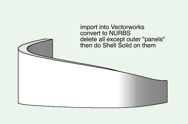

Because I cannot find a way to "thicken" the outer faces of a T-spline-cut extrude in Fusion, I've exported it into Vectorworks...
But upon importing back to Fusion, it's now hanging in "translating the *.stp" after the upload. Progress bar seems forever orange.

I believe this is possible with Fusion 360 when combining tools from the Model and Patch environments.
The trick seems to be to project the T-spline edge into a 3D sketch.
  1. Make T-Spline
  2. Create new sketch and project with "Include 3D points> This will leave you with the 3D edge from the T-Spline in this new 3D sketch.
  3. Change to the Patch environment
  4. Select Create->Extrude and select the 3D sketch curve as the profile. This extrudes into a surface.
  5. Change back into the Model environment
  6. Select  "Create->Thicken" and thicken symmetrically to otherwise as desired.
  7. Trim the bottom with a another sketch and a extrude-cut.
