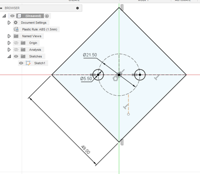

I don't know what happened - but notice that there is no longer a red lock symbol on your Sketch1
Click and drag point from the Origin...
There is an unconstrained endpoint on a Construction line.
Make this white dot Coincident to the Origin.
