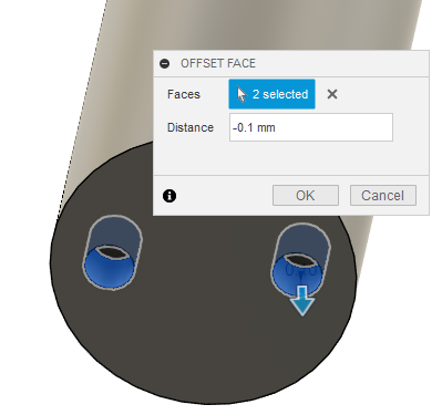

Change the visibility of the bodies and now Extrude-Cut the circles into the cylinder a distance of 6.5mm - this gives us a little clearance on the depth...
Now Offset face the cylindrical faces of the holes by -.1  this gives us a little clearance for the pins as we can't print perfect parts.
Add a .5 Chamfer for lead-in for the holes...
