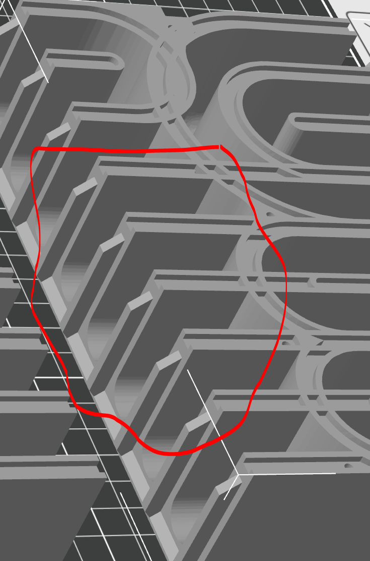

Can someone please explain how I can reproduce this tongue/groove effect when splitting a body (such as a box) into two halves?
The resulting enclsure needs to be as close to air-tight as possible after printing and re-joining, so this seems like the ideal approach (and it is is commonly found in STL files others have created for speaker enclosures)... but I can't seem to find the right search terms that result in the workflow I am looking for.
Any help would be greatly appreciated!
--Sean

The geometry is poor quality.
Are you willing to start over from scratch with step-by-step instructions?
Message 5 of 39
ComputerAidedDisaster
If that is the only option, I suppose... (and I appreciate the assistance either way, please don't think I am ungrateful)... but that defeats what I'm trying to do, in this case.
I'm trying to take someone's existing design (stl unfortunately) that is fairly close to what I need, and convert it from mesh to solid, make the adjustments I need to get it the rest of the way to what I need, and add the tongue/groove so the split can be re-sealed and nearly air tight when finished....
Is there really no way to modify existing, lower quality geometry (i.e. mesh from an STL import) to get it to the point it can be edited this way?

and.... wow.   that is amazing to see how you simplified the end result (in it's unworkable, post-mesh-conversion form) down to something so minimalistic and used the pattern to great effect... I've used the pattern, but not nearly that effectively.
That will be a big help going forward as well as making the main shape solid and then shelling it.... I've been sketching out the part one dimention at a time, extruding the walls manually... horribly inefficient, in hindsight.   Which is why I was avoiding re-creating this thing from scratch to make it workable.... my way would have taken forever and been absolutely miserable compared to your much faster, much more elegant approach.
One question so far...How can I find the variable name of a dimention in order to reference it like you did with the Dx/2?  that will be very helpful as well.
I've asked questions on forums plenty of times over the years, for various tools/apps/etc....  but I've never gotten the kind of detailed, step-by-step walkthrough you just provided.... I'm blown away.
Thank you very much for taking the time to show me "the right way" (or better, anyway) to do all these little aspects of the workflow.   this is going to help me tremendously and I sincerely appreciate your time and effort to help me out.
