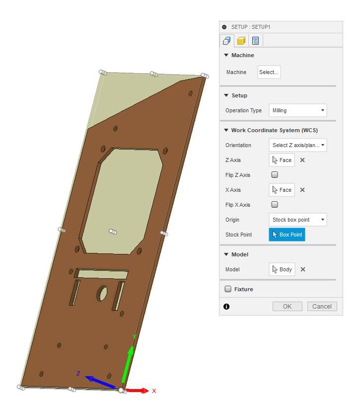

I have one more question for you.  how do I put the attached file flat either on the X or Y axis to get ready for milling?   I have a number of these that are standing on the Z axis and need to put them flat?  again, sorry for the basic question.
thanks for the help!  can I buy you a coffee?
Message 23 of 28
etfrench
The simplest if you're doing one at a time is to set Z and X in the Manufacturing Setup.  If you're doing several at the same time, then I would make a copy of each in a new component (labeled CAM). Use a Planar joint to arrange them.
You could also use Nesting which was introduced several updates ago.

Like this:
