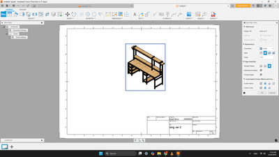

Hey,
I designed this desk,
 but I want to make the dimensions visible—something like this.
Is this available in Fusion? If not, how do you suggest doing it?

eyadserry
when I add to a drawing it appears pixelized.

Drewpan
I would check the graphics settings as the model should not be pixelated in any way.
It should look exactly like the model in the Design space since that is what it is based
upon. You can find graphics settings in the Preferences tab.
Cheers
Andrew

Drewpan
Most commonly it simply involves resetting the graphics driver. If it is Auto then select OpenGL
This will sometimes fix it on its own or sometimes you will need to restart fusion. Sometimes
you need to restart and set it back to what it originally was. This will most often fix it. If it
persists then you might need more professional help. The Devs will monitor for this sort of thing
and contact you if they can help.
Cheers
Andrew

eyadserry
It somewhat solved it, This solved the pixelation but the object came out blue color.
