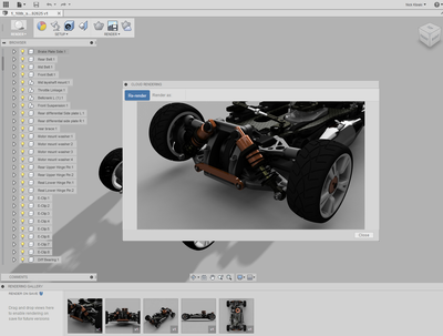

Hopefully this is something obvious that I am missing:  I did a cloud render, but I cannot see any way to save that render to my hard drive.  I clicked on the render, and a little window popped up, but there is only a "re-render" button and not any option to save.  Right clicking does not work......the cloud render completed successfully, but I can't find where to download it!

Hello nkloski. Your case maybe a bug. Cloud render in my software works well (such as in image below)
Cloud render
Why dont you try to use local render? Maybe that can be solution. Thanks.

Ah, for some reason this morning, now I see thew download button! (I couldn't use the local render because I needed a resolution that was higher than my monitor resolution for use in a print publication.
