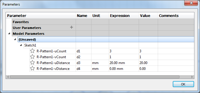

The work-around is to use the Modify/Change parameters menu:
Then change the spacing, count etc as desired:
Happiness at last!

Thanks.  Yes, with hindsight patterning the arc features would have been better (I wanted to put them around a curve - hadn't realised there is a useful "Path pattern" option to do this).
Interestingly, if I try "Modify/Change parameters" on my sketch the dialogue box shows one pattern but actually there are two (vertical with 2 instances, horizontal with 6 instances) so there should be "Pattern1" and "Pattern2"...maybe a bug?
