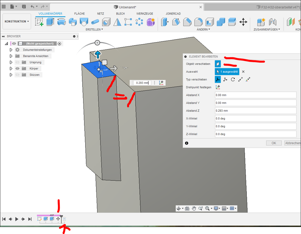

davebYYPCU
You have 2 faces that are not overlapping.
It works like Extrude to Object that one is under the other.
If face 1 has to be the same height of the face 2, you can extrude face 1 above the level of face 2,
use Face 2 in Split body to trim to the taper angle.
There would be other ways.
Might help....
