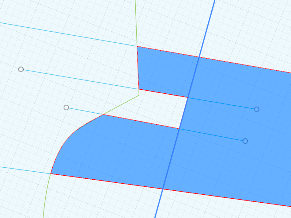

I have a curved surface that I want to emboss some text (imported as .SVG). At first this worked perfectly fine (see "Emboss working.f3d"). However, I wanted to scale down my text a bit. I used the scale command in the sketch workspace to scale it down. After doing so, when trying to emboss the "U" letter it gives me the error "Sketch profiles are not coplanar. Deselect sketch profiles that are not on the same plane." Even when selecting only the "U" letter (only one sketch profile selected, it still says that multiple are selected and that they are not coplanar. Model "Emboss failure.f3d" shows this error.
Has anyone experienced this before? I assume it must be something with the sketch profile of that specific letter that Fusion has issues with, but I can't figure out what's wrong with it.
Also if someone could confirm that the "U" letter cannot be embossed using the emboss command it would be very helpful.

jeff_strater
it looks like the "U" is the problem profile:

jeff_strater
even more so, it's the lower curve in the U.  I tried deleting and re-adding a curve there, but that still seems to have the same problem.

TrippyLighting
I believe Fusion 360 encounters a problem intersecting the sketch curves with the curved surface.
Extruding the text to combine with a flat surface works fine and is a stable workaround:
Message 9 of 24
TrippyLighting
@jeff_strater I believe this isn't per-se a bug, but a near tangency problem.
The sketch is an imported SVG and all the imported curves are 3-degree splines that seem to be tangent.
I modified the bottom curves of the U in that I made the construction lines that form the spline control cage,
 colinear with the construction lines of adjacent  splines,. Then it works fine.

jeff_strater
"So, I make the theory that it something to do with the font used."
Your theory is correct.  We have no control over the quality of the font outline produced by various fonts.  In this case, the error message is misleading.  Has nothing to do with co-planar profiles.  It is just that the "x" here does not define a valid profile outline.  The other letters are fine.  You can tell this by "exploding" the text.  I can emboss those letters just fine:
using the "divide and conquer" method, I tracked it down to this section of the "x":
and further identified this line:
as the culprit.  Deleting that one and replacing it with a sketch line allowed the whole string to be embossed:
The repaired model is attached.
