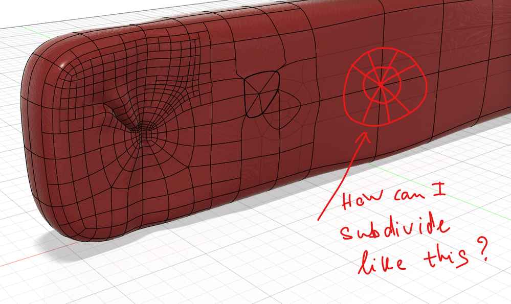

Hi Peter,
I think John's idea is better in this case. How can I subdivide as picture below?

TrippyLighting
Johns screencast shows one technique. As it did not make much sense to create a screencast showing the same technique my screencast shows another. Both can be combined. This isn't a case of one is better than the other 😉
The way you are modeling it is very easy to create self-intersecting geometry and if you start subdividing the way you do it you'll end up with a very heavy model. As a beginner you should model in quads only. Most experienced Sub-D modelers model 80%in box view mode and check in smooth-view mode. Not the other way around.
