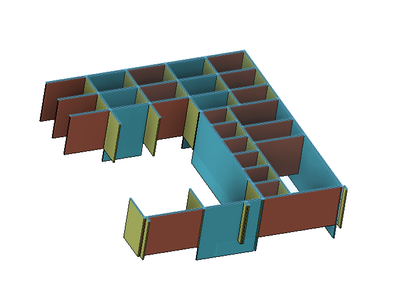

See demo GIF, How can you do this in Fusion?
The design intent is to take this sketch of 41 closed sketch curves turn them into components and use the arrange operation to nest them on sheets in the least amount of clicks as possible. 🤔 Sample file included.

To get to the result in Fusion using the Spilt Body Method, it takes 100+ clicks compared to 3 clicks with Rhino 3d ...See demo video
I am sure that Fusion can recognize "closed curves" as know in Rhino.... Wouldn't Fusion call them a "closed chain"?   Anyways it would be a huge time and risk saver if we could figure this out how to do it in Fusion...there's got to be a way.😎

Why would you need a hundred clicks?  Just draw the splitting lines in one sketch and do one split body command.

On the other hand, why bother with splitting bodies when  your sketch already has them separated?  Simply extrude all closed boundaries that don't touch other closed boundaries.  For this model, it only takes three separate extrudes.

Big thanks to @etfrench for the solution. 🙏
I would prefer that fusion recognized close curves or closed chains so that we can all the select whole sketch at the one time but the accepted solution works.

Use lines instead of rectangles in your sketch and use thin extrude to produce the bodies.

@tookemtoni You can also automate the process by using the Fusion 360 API.
Create an empty script by following this tutorial: Creating a Script or Add-In
And replace the code in the script by the one below:

Run the script and select the sketch in the object browser.

Thank You @JeromeBriot 💥
See updated script below with parameter control.  Just add extrusionHeight and smallSideLength to your parameter table,
