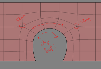

I am having some trouble completing this model after exiting the sculpt workspace. I need advice on how to model it so that it I can work on it in the patch workspace.

If you go into the folder Front Bumper you will see Front Flare. I want to use it to split the Shell, then delete the resulting inner face of the Shell so that you could see the Flare design. Also, I was having trouble creating a patch for the back of it so that you wouldn't see right through it into the car. I created Bodies 55, 56, and 57 by seperating the body into three parts and using it as such. It worked but I prefer to have it as one whole Body. If you have any better ideas I would appreciate it.
Let me know what you think of the design overall and what else I can do to improve it.

I would suggest over building all your surfaces.  the front flare doesn't fully intersect the shell.  you will need to pull the edges out so it comes complete through the shell if you want to use it as a trimming tool.
transitioning from a t-spline to the nurbs space, and doing further nurbs surfacing tasks is tricky, and there are a number of pitfalls to look out for.
-surface geometry around star points will always be a bit wonky.  so you want to place them in areas of low curvature, instead of areas of high curvature like you have here-
creases should be minimized (or eliminated completely) in t-splines, but if your going to use them, never run them through or into a star point-
-avoid anything but 4 sided faces, especially around geometry like wheel wells-
avoid all of the above with better topology.  for instance, use edge loops around the wheel wells-
