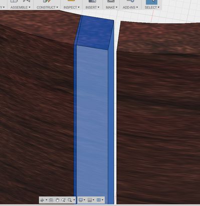

Here some pictures of how I do it.
There are probably different ways to do it.
I've also tried to extrude to get rid of the gap but because of the flat part,
but the circle is never perfect.
The way I do it now leaves a perfect shape.
But be warned, you will loose the unfold capability after you delete this !
This is the folded cylinder, you notice 2 flat parts and a gap.
Here's a close up.
Select every face with ctrl, select the faces on the inside of the cylinder and bottom as well.
Now press delete and the magic happens, a perfect cylinder appears !!
