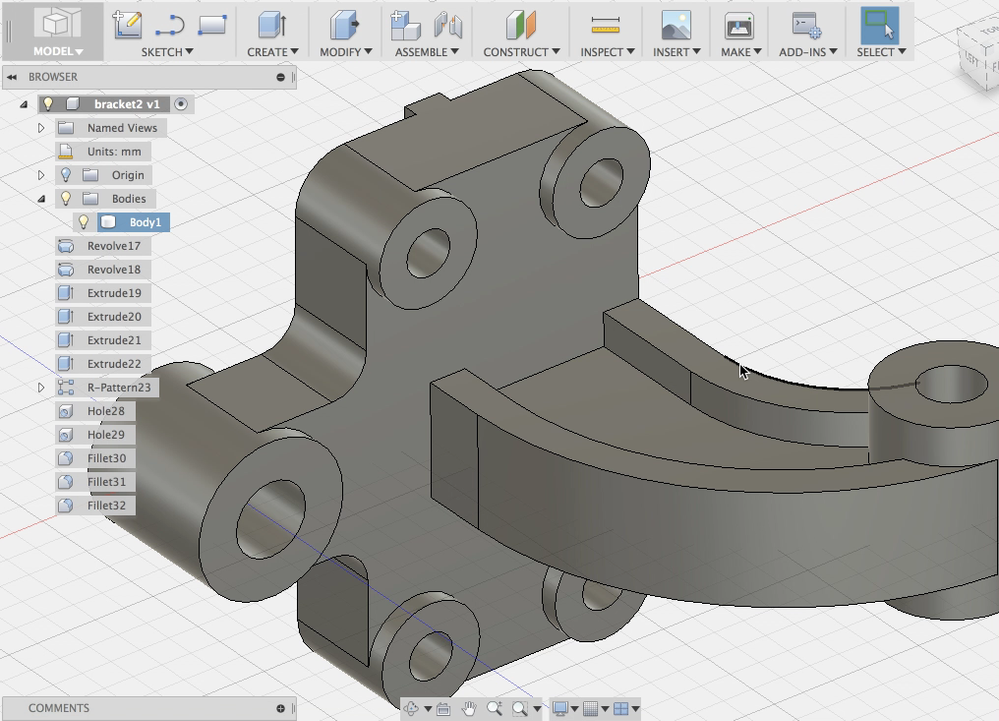

Hi Vonissar,
thank you for the trying the Fusion 360, welcome !
Now back to your question. Unfortunately Fusion 360 & Solidworks aren't "synchronized" as you expected. Models from the Solidworks are imported after the Upload as bodies.
BUT in the Fusion is a tool called "Find Features"
Find Features
It's a feature recognition tool so all recognized Features:
aren't features from the original model but you can edit them or Dissolve them if you aren't satisfied:
So no you could have your model and recognized Features.
Now you can continue in Direct modeling mode or enable "Capture Design History" modeling mode when you can making parametric models.
I hope this will help you.
 Regards
 Roman

Hi @Roman_Vesely,
As you pointed out, the "Find Features" tool only works when the design history is disabled. For me, after it finds some features, if I then enable design history, all of those are lost - the feature tree on the left just has the imported body and the timeline only has one item: the base feature from the import. Were you able to preserve editability of the recognized features after enabling the design history?
Thanks a lot,
Jeff
Message 14 of 15
Hi @roman_vesely,
Thanks a lot,
Jeff
Message 15 of 15
Roman_Vesely
Hi Jeff,
 once you have enabled "Capture Design History" you have created "Base Feature" in the Timeline. If you want to edit "features" which identified command "Find Features" before, you need to select "Base Feature" in the Timeline, do RMC and select Edit (or just do a double-click on it) :
All "Features" are available for editing:
That's all 🙂
Regards
 Roman
