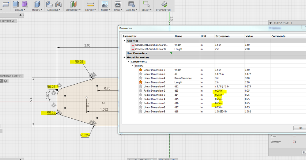

Here is a perfect example in  a simple sketch. I have 4 parameters with the same value. I want to know which on corresponds to the sketch.

@crullier there's no user parameters in your pic you have to click that green + to create them.
d4 to d7 in you pick change the diamention to d3 what are fillets

I meant to say MODEL PARAMETERS.
At this point its just a guessing game to know which dimension corresponds to what fillet.  This is just a simple example to illustrate the challenge.

From the change parameters dialog box yes it is, when it's open unless you rember what is what it does show what component that diamention belongs to but not the action.
If you set user parameters it is a lot easier
If all fillets are to be the same size after you have done the first one when you goto set the next one's size click on the first ones diamention that will set it to be the same or setup a user paramater.

So the answer to my question currently is that the user must guess, or make note of parameter names on a piece of paper before opening the parameters window.
Here how I imagine it "should" work, my humble suggestion:
When in the parameter window, when you select a parameter, it should highlight in the sketch. This way you know efficiently, what parameter corresponds to what dimensions, and thus rename them without any guess work.
I am not taking about how to set the parameter equal to one and another, or adding formulas. That is pretty straight forward.
