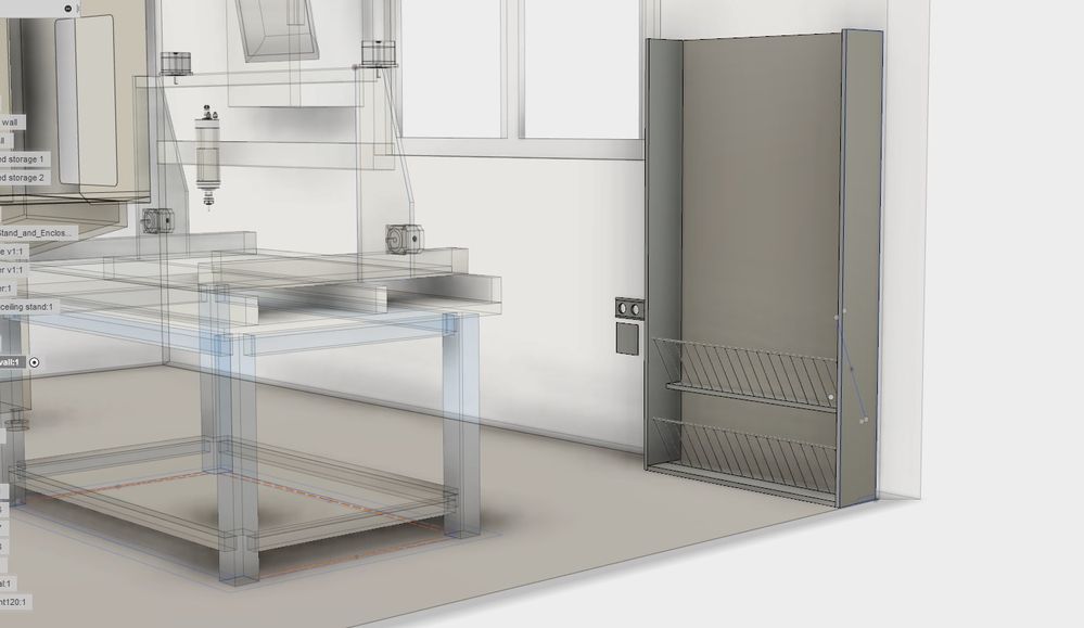

I started again to play with Fusion, I was thinking while I learn to model it's a good ideea to start modelling something that will be usefull for me, so I started to model my workshop space, right now I try to think of the best way to store the sheet of policarbonate, and fiberglass that remain after I mill from a larger sheet, every few days I also need to mill smaller parts and it's nice to have them separated by thickness, when I'm looking for a part to look exactly in that compartment.
 CNC_Room_2017_2017-Mar-27_06-35-05AM-000_CustomizedView7755424620
I try to model the metal part bello, I want to cut it in half, and use each half for one shelf. So I made a 5mm circle and I tried to find a way to duplicate it 22 times, I could only find Rectangular pattern command, and made 22 copies of that circles. But now I can't extrude all at once, I can make the first one, but can't select the other. Also If I extruded the first one, others didn't extrude.

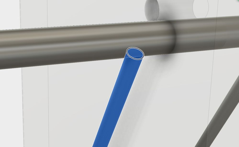

I made the copy, but now after I created another copy of one body, and scale it 2x to make it thiker, rotate it and placed it above al the multiple copies, I almost made what I wanted, but noticed I made to many copies, and now I'm having trouble deleting them, and even make the top horizontal bar smaller by using Extrude command.
For the extrude problem, I selected the end of the horizontal bar , press E, and move the cursors as you can see in the picture, after pressing ok , nothing happens with the bar, it remains the same size.
And about deleting horizontal bars, I noticed I can't delete it by selecting the face, if I double click it selects all the other bars, I could only delete it if I selected all elements of a bar, the top and bottom contour, the face of that contour, and the cilindrical face, but it was a pain in the a** to select all those as also zooming seems weird sometimes, sometimes it moves very very little
So in the feature, what I should do when i want to create something that interconnects with other elements and I might need to modify them , like in this case, the horizontal bar had been place on top of the vertical bars - touching each other
Message 7 of 13
ovisopa
I figure out, I think I couldn't extrude from that end because that was the origin of that body ? I noticed when I tried to move it that the arrows appeared in that end, so if I moved it to the right, and than extrude the other end , in worked.
