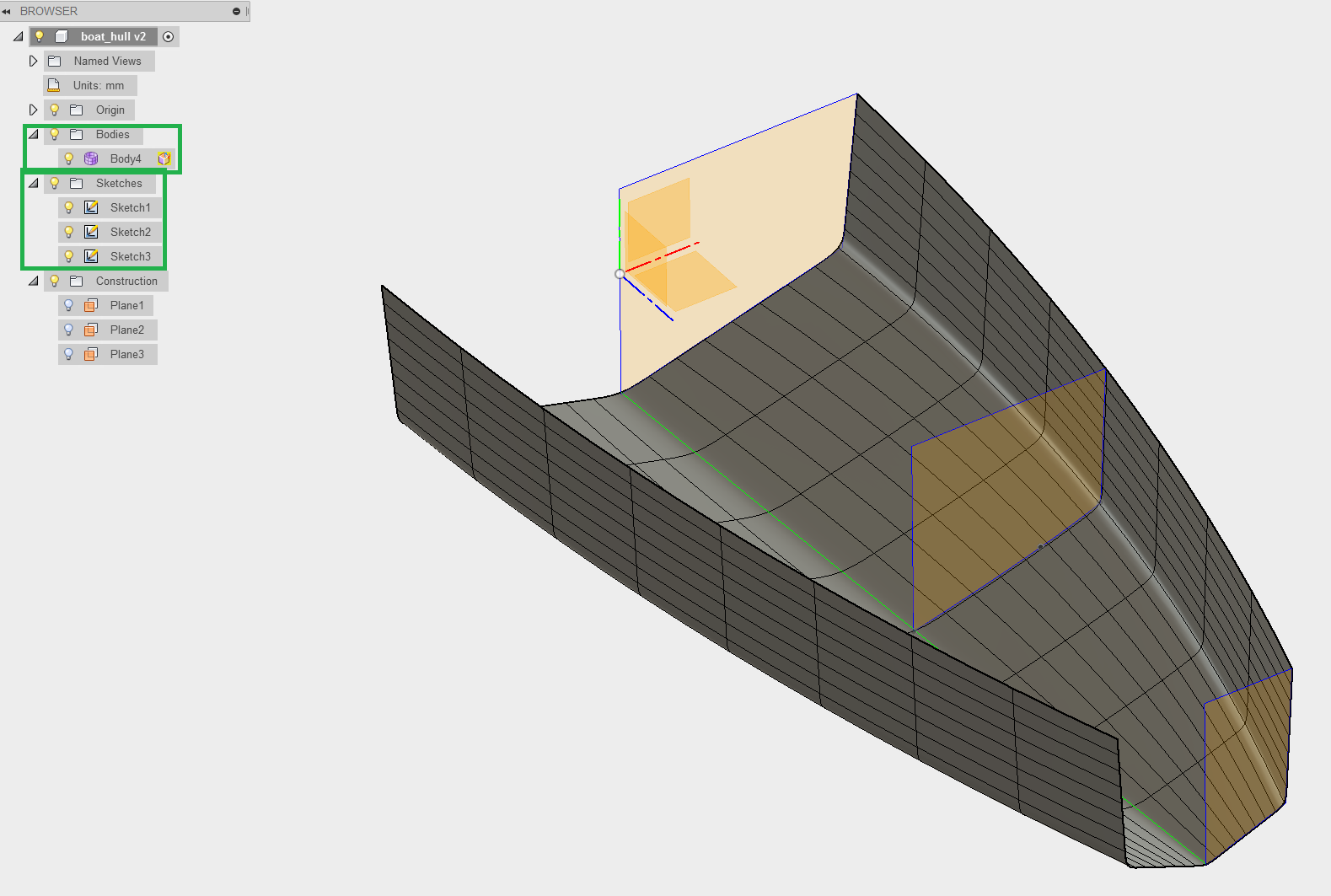

I want to do some power boat hull design. I've had some parametric modelling experience with solidworks but I'm new to Fusion 360. The end game is to build a 4m long open power boat from CNC cut flat panels (e.g.plywood or Duflex). I must understand how to draw this myself rather than borrow another design from grabcad.
I'm having great difficulty getting started and getting the basic chined hull form modelled. I'm sure there are plenty of ways to achieve this and it sounds simple but so far I can't control the basic hull shape..
1. I want planar bottom surfaces in the aft half of the boat (for efficient planing).
2. I want curved surfaces in the forward half of the boat that can be formed from flat panels (e.g. plywood or duflex).
I've tried sweeping sketched lines and sculpting t-splines but not with good results so far. I'm having difficulty with the combination of a curved surface coming off a flat surface.
I've attached a screen shot of a basic hull shape I sculpted from a t-spline box on the weekend. On close inspection the aft end bottom panels aren't flat even though I used the "flatten" parallel to a plane command. The aft "flat" panels appear to be affected by the curvature of the front of the boat (the bending spline). The t-spline surface appears to be distorted (more visible with zebra analysis) around the "flat" to curved transition area. I also don't seem to be able to add dimensions to control the size of the t-spline box. I can sculpt and pull the t-spline box to a rough dimension but not set an editable and accurate length, width, height, angles like dimensioning a sketch. Appreciate any advice as to how to accurately sculpt a hull from a t-spline box.
Also appreciate any advice as to whether I'm heading in the wrong direction with sculpting t-splines and suggestions for a faster, more accurate way to get a basic hull shape modelled.

Hi @andrewWMZPK,
Thank you for posting your question to the Forum.
Your design looks good, you might just want to add more edges to give your boat more details.
An option to design basic the shape could be achieved by using sketches and the loft feature in the sculpt environment.
The trick is, you would just create one side of it and mirror the other side, like in the picture here.
I have just created that quickly but you could follow this work flow:
  1. Create a number of planes which might be sufficient enough to represent the surface
  2. Create a sketch on every plane that woul represent a cut in this section of the boat
  3. Use the "Loft" feature in the "Sculpt" environment and select multiple sketches
  4. Delete the surfaces you would not need and mirror your design
Here is the link to the example design. Please, feel free to use it. http://a360.co/29HVRzu
I hope this helps and gives you more ideas how you could design it.

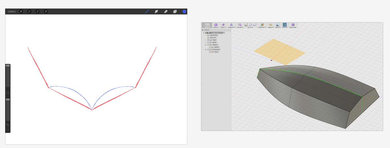

davebYYPCU
I was following this thread to see how sculpt might work for my work, (model aircraft) and you now seem to have dropped sculpt, going for patch (or solids) to output your boat panels.
More to the point Fusion can't flatten surfaces after obtaining the 3D model, but sheet metal is on the way....
An answer to your last post, I can't check this on IPad, so here goes, depends on what you have done first, bulkhead sketches, or spline sketches,
the result is the same, but techniques are different.
If the Rails came first, my method,
I obtain Loft Rails, by drawing / dimensioned 2d curves, in the top and side view, then using "Intersect Curve" in the project menu area, to develop the 3D chine, as a 3D sketch.
then it is a case of draw the bulkhead sketch/s, and "Intersect Project" the spline line, a red projected dot is the result,
and the sketch profile MUST snap to those projected dots.
If the bulkheads came first,
then using "Incude 3D Geometry" project the spine point of intersection from the bulkhead sketch/s into you 3D sketch for the chine/spline, and draw the spline snapping to these points.
Loft is very good at previewing each selection, will not continue if not happy.  It's very hard to find the source of the errors, so I normally select the first 2 bulkheads, then one rail at a time, when I have all the rails working add more bulkheads, helps debug the intersection errors if you missed a snap point.
Hope that makes some sense, will check your file tomorrow, if you need something else.

Hey Andrew,
You were so close, the Deck curve and Keel curve were both working as I found it,
I have updated the file with new name, so you can check out what I did,
From what I found in V8, I turned your chine sketch off, but did not delete it, there were two bow sketches, left the obvious one on, turned the other off.
Created Sketch 12 so you will find it, on the centreline plane, and making sure it was a 3d sketch, tick box in the sketch panel.
Then in the Project Menu, used "Include 3D Geometry"and selected the three chine points,
Drew line from rear to mid profile, then tangent arc to the bow, for the new chine rail.
(I didn't try to move your chine lines, was easy to replace it, let you compare / edit them,  and you can try the move now that the snap points exist.)
I see in your post you wanted a loft to be produced, went to patch environment, and got it working, had a crash, and some odd behaviour with the keel curve, had already tested it was OK
so selected it as the first rail to make it behave, Loft can be like that,  (It's turned off at the moment, so you can open the feature and check the selections)
I saw that App today when surfing the net for something else.  I haven't used it either.
Away you go...
Browny
