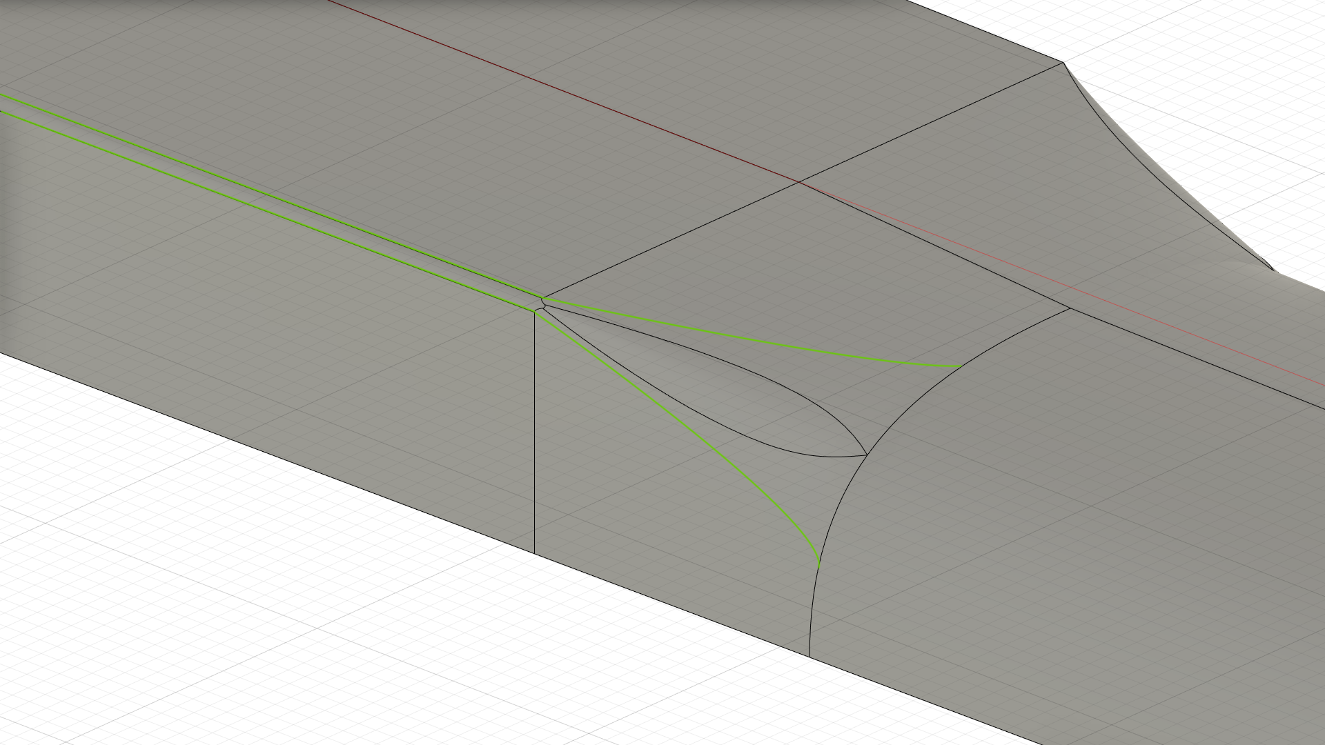

Attached is an image with green lines I did in Photoshop that shows what
kind of Fillet I need but I don't know how to do.
Anyone here know how or got any ideas?
I'm stumped.

laughingcreek
typically you would do a variable radius fillet, but your geometry looks a bit funky.  if you can get it back to a clean edge then it shouldn't be hard, if not might take a bit more effort.  can you attach your model (preferably an original fusion file with the history) you can export the model as a .f3d and attach to a post

jda70az
Don't let the black lines fool you. I did 2 fillets on two edges of the variable radius type
and that is how it turned out.
Anyways here is the file.
Message 7 of 19
jda70az
The fillet is going in the wrong direction. The start and end are reversed.
I need it to go the other way. From the sharp edge on the left to the curved edge on the right
How do you change that?

If you see the first picture I posted above, I would switch the direction by putting 11.5 in "Start", and 0 in "End", basically swap the values.

fusiondesigner
Several things:
1. The file you attached is probably an older version, there was no "Body18", but I think I figured it out.
2. I think you are thinking about the filet in the wrong direction. The rounded sketch profile (endneck) side already has a radius, so you do not need to apply a filet to that side. But still, because its a loft, Fusion 360 can behave weirdly.
3. The problem with the weird behavior gets solved if you create the loft as a separate body, instead of merging it with the rectangular neck behind it.
4. See attached. I edited the loft to be "New Body" instead of join (this created a Body18). Then played around with the filet on the lofted body until it looked right. Then set the filet/radius on the body behind it to match. Then you can combine the bodies back together.
