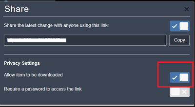

There is no download permission
1. Create a source that allows downloads > “allow download”
2. Zip the f3z
3. Remove the links  (chain symbol)within the design and attach as f3d

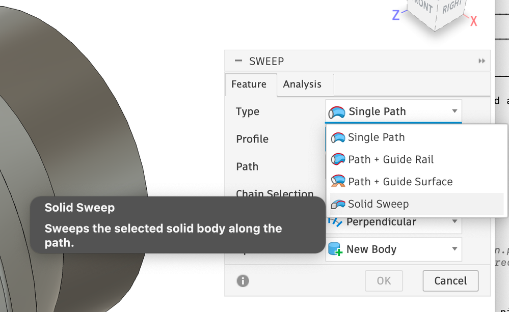

Another command to look at is "Solid Sweep".  This command is made for exactly this kind of requirement:  Creating packaging, jigs/fixtures, or a stand from a solid body.  It allows you to "push" a solid body into another solid, that will allow for undercuts, etc.
However, the fact that you cannot select the camera body as a tool body in Combine suggests to me that the STEP file is either a surface body or maybe a mesh body.  Combine (and Solid Sweep) both require complete solid bodies.

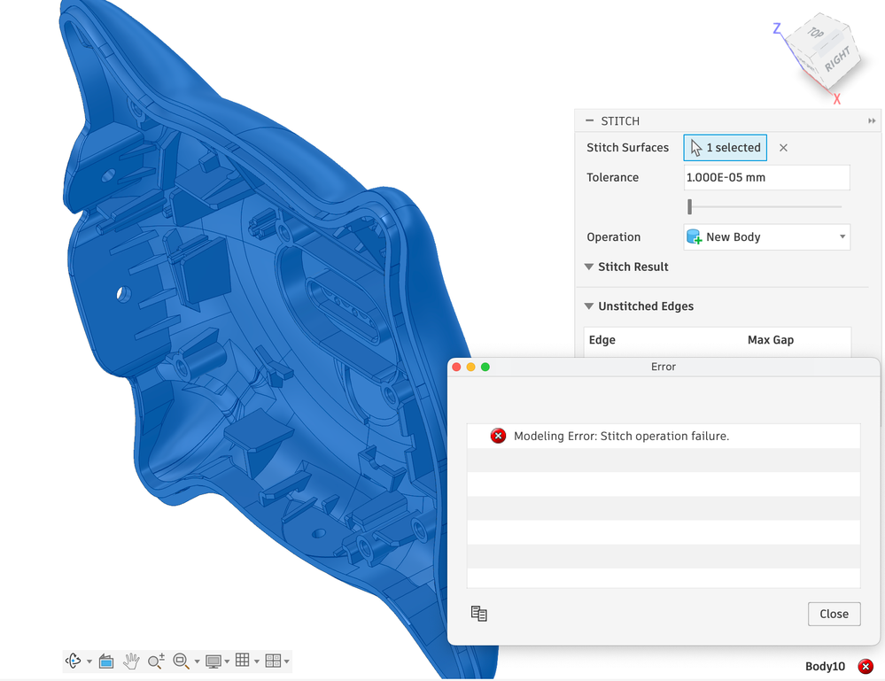

I did  quick try to see if I could stitch the surface into a solid.  No luck, and the error message is not particularly helpful:
even adjusting the tolerance does not help.  I'll have the geometry team take a look at it.

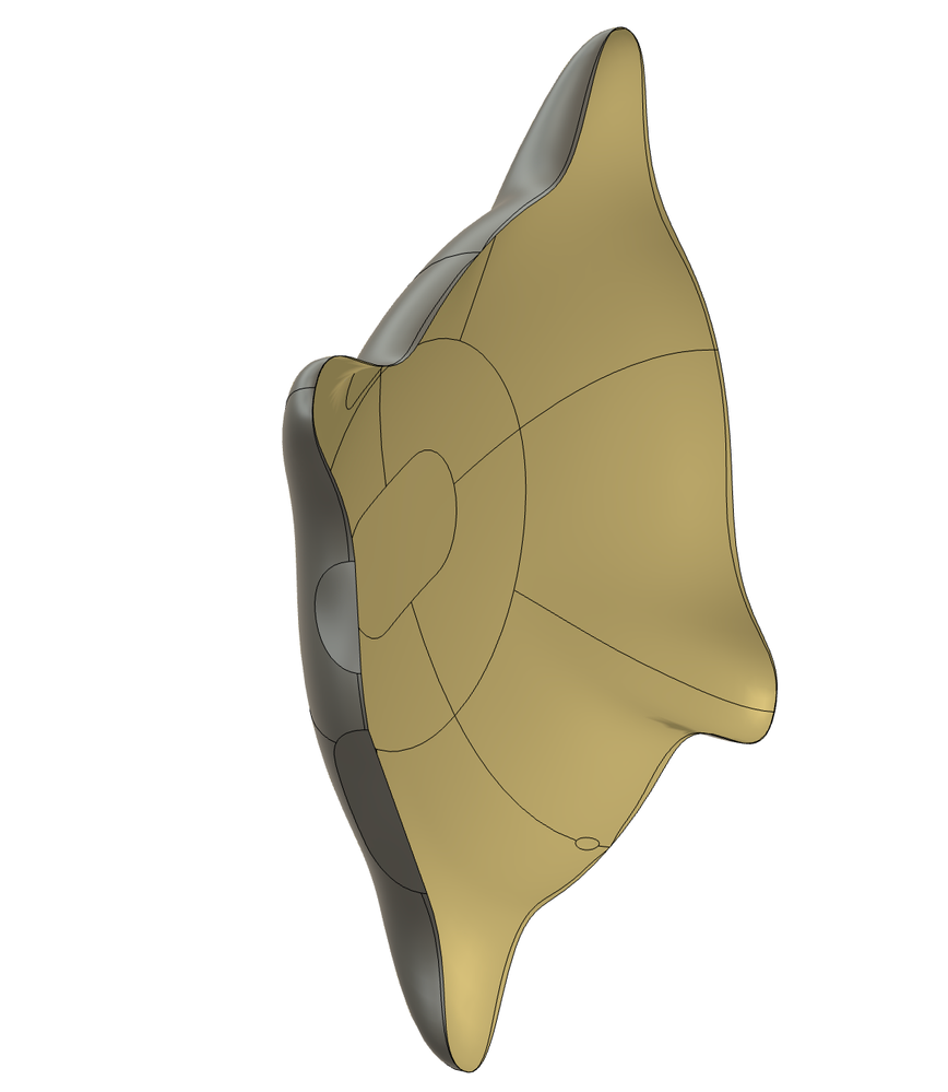

I created a zero offset surface from the outer side of the Looki:
Then, I deleted some extraneous faces, and patched some holes to get this:

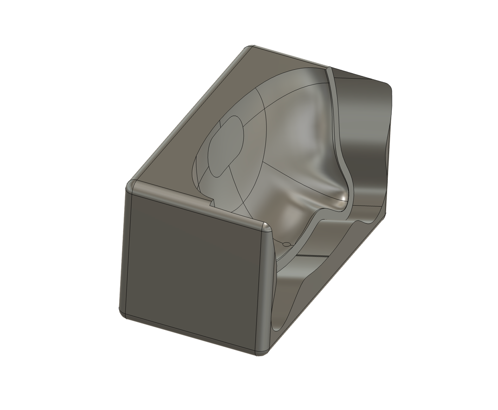

Which I could then use as a splitting tool in Split Body to split the stand body, to get this:
Model is attached.  All the messy surface operations are in the timeline group "surface cleanup".
This is a useful technique that you can use for this kind of thing, although its usefulness is limited.  This model does not have any undercuts, which helps.
