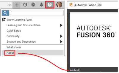

Message 12 of 13
WHolzwarth
Hmm. I'm here with Release 2.0.12157 of Fusion360. Are Education licenses limited with updates?
Walter Holzwarth
Message 13 of 13
TheCADWhisperer
@rajsumanth9 wrote:
2.0.10806
windows 10
Find the Fusion 360 Client Downloader *.exe and double click to force an Update.
Search your hard drive for this file.
