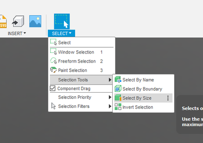

When reporting performance problem you need to be more specific.
Moving and joining assemblies with many components is slow. However, if you don't move your  PCB but design your "whatever" around it you might never experience that slow behavior.
Another area that can get slow is selection. Fusion 360 uses pre-selection highlighting and that cannot be turned off. For that to work, Fusion 360 continually looks for selectable geometry in a cone shaped volume protruding from the mouse cursor. The more geometry  is available in the view port, the more slower it can be.
I  would create a selection set of those things you don't need to see and then hide the selected items and/or set them to unselectable. You can select bodies, or components by size ( look at the selection filters) :
With a bit of pre-planning this can work.
