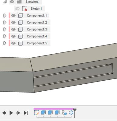

I'm trying to design a way to have this frame (in the shape of a pentagon) have interlocking parts that can be 3D printed and glued together. I've tried various sketches with extrusions but I think it's been done in a non-methodical way that could be done much better.
Here's the 5 parts all together:
For this part, I tried to extrude the locking piece by sketching on the top. However, I can't figure out how to make it thinner to slot into the next part:
For this body, I managed to extrude a slot, but the lip is stuck in body 2, when it should be in body 1. I suppose there could be a way to join the lip to body 1 in the patch workspace, but I still think I'm doing this really wrong: Screenshot_2.jpg
Is there a better way to do this? I'm really at a loss.  Thanks so much.
Actually, you have 5 instances of 1 component.
See Attached.
No Planes, one simple sketch.

Oh I see that's a great and simple way to interlock the parts! Thanks
cyangaze
Interesting option! I like the button-type slot.
cyangaze
Wow this was exactly the solution I had in mind. Well done with the circular pattern and component repetition. I now see the workflow in this example (as well as the other responses) in the extrusions and with one sketch. This was what I was thinking, but of course the other examples also worked well. Thanks again!
