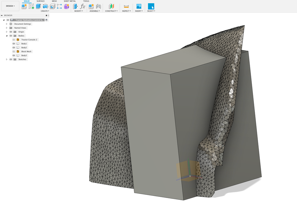

I am trying to design a project box, which will be 3D-printed, that is contoured on one side to fit the instrument panel of my tractor.
I 3D-scanned the tractor instrument panel with my iPhone and Scandy Pro. I then edited the mesh using Meshmixer. As my last step in Meshmixer, I extruded the face 0.1mm to create a solid body mesh.
I then imported the solid body mesh into Fusion 360 and converted it to a Fusion 360 body. I also created a primitive for the project box.
What I'd like to do is split the primitive into two bodies using the instrument panel body. However, when I do this using Split Body (selecting the primitive as the target and the instrument panel as the tool), I get the following results:
Body 1 = Instrument panel
Body 2 = Intersection of instrument panel and primitive
Body 3 = Primitive, with the instrument panel cut out of the middle
If I flip/flop the target/tool, I get a variation on the above.
I can extrude the unneeded half of the primitive to a point, but because the lines of the instrument panel are converging, that only gets me so far.
So...how can I split the primitive into two separate bodies using the instrument panel?
Thanks!

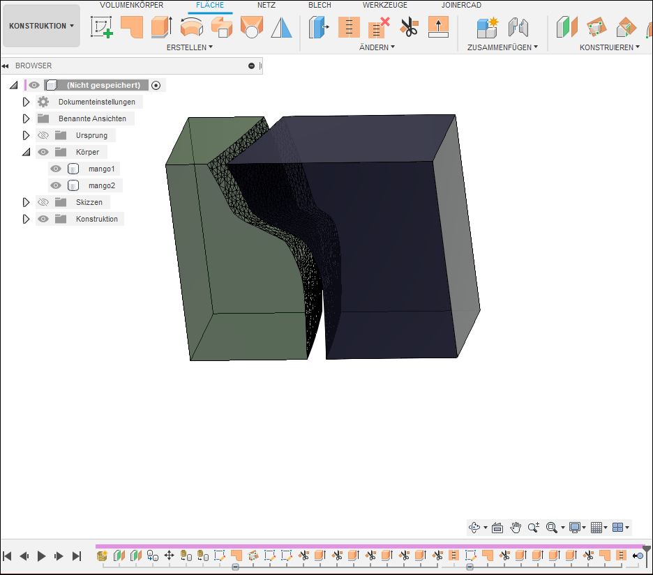

mango.freund

@mango.freund - Thanks, but I may not have been clear in my explanation. I'm trying to create a shape that will rest on the contours of the mesh, not cut a hole in the mesh.
To say it differently, the mesh should remain unmodified, and the shape that's in your file as Körper2 should be cut in "half" by the mesh.
Appreciate all the help so far!

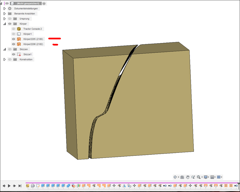

mango.freund
Hello, @matt.culik unfortunately you thickened the network so that a lot of edge surfaces were created. the work is almost finished except for cleaning the form rims and then stapling.  go in the time before the stapling and clean - the edges on both sides.                    greetings  mango

mango.freund
Hello, set the correct position and size in the sketch. greetings mango
Message 16 of 16
matt.culik
@mango.freund  - THANK YOU! This is perfect and I was able to use the timeline to see how you did it. Apologies for the delayed response. Was a hectic week at work.
