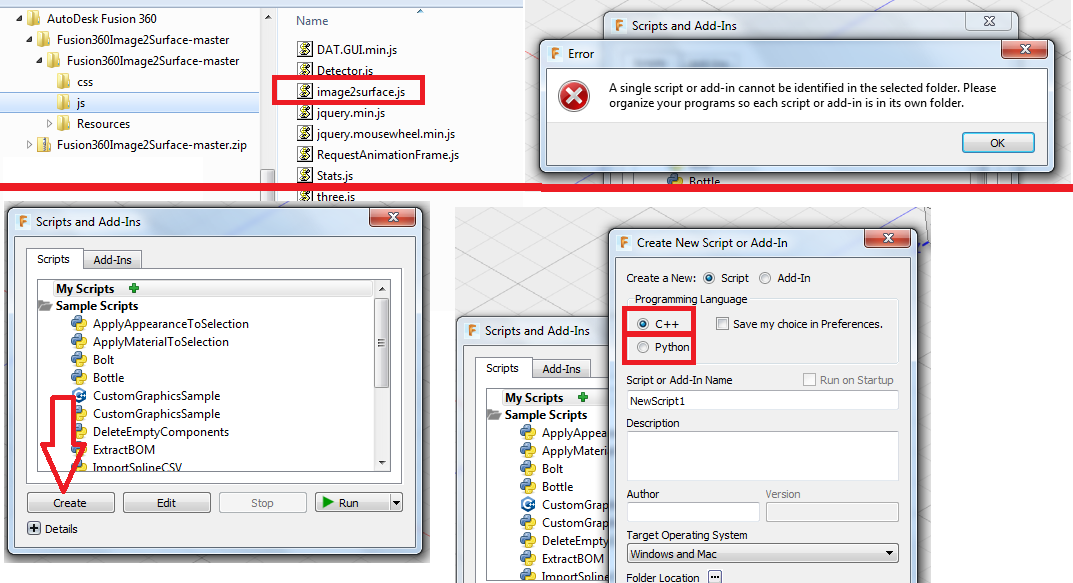

Hi - thanks for trying to help - BUT!!!
I follow the instructions provided in the link and all I get is this.
And this is ALWAYS the way it goes no matter what the package is.
What you are told to do does not work and eventually you find out that "oh but you missed a step" (which was not therein the howto !)
OR the version has changes and now you have to enable this or that obscure setting or something equally ridiculous to expect someone who has opened the package for the 3rd time ever to know about.
CAD/CAM packages are hard enough to think about, never mind to get working when it is your first time.
Its looking for a folder - so I navigate to where I extracted the download - its not interested.
OK - so I create a folder - that did not work either.
The whole world seems to be raving about Autodesk and how easy it is.
Well, not from where I am sitting. And I am not the only one...
It wont allow me to get past the "Select Folder" step ....

Sorry for the confusion. You've unwittingly stumbled into a known issue that has been fixed. When using Javascripts, there must be a manifest file in the package in order for Fusion to determine which js file is the right one to use. In the case of the Image2Surface version linked in the Instructable, the manifest is missing. It has been fixed in the official repository.
TL;DR
Use the official repository instead of the version linked in that instructable (or the file I link here).
https://github.com/hanskellner/Fusion360Image2Surface
Again, not your fault (and not the instrucable's fault either).

Tried a number of things - the first image is as per instruction. It error-ed!
The 2nd image top part is where I went to look for the js script but when I pointed to that directory, it error-ed as well !
The lower part is where I tried to create it - but that was obviously not the way to go because it is looking for a C++ or Python option - and I am sitting with a JS script.

Thanks @I_Forge_KC for sticking with me on this - appreciated!
So I tried as per your last post.
Here are the results - one gave an error message, one gave me a box which does nothing (except the "Create" - but I don't think that is the correct option).
And people wonder why I use "MS Paint" for my "technical drawings" ....
Maybe I should uninstall and start from scratch again...

I_Forge_KC
Go to the add-on tab instead of the script tab and it should be there.
The newer version of Image2Surface doesn't launch like the old one does. Once you run it from the Add-On tab you then go to the Add-Ins button on the main ribbon to invoke it.
You're getting closer! Sorry this has been a hassle.
