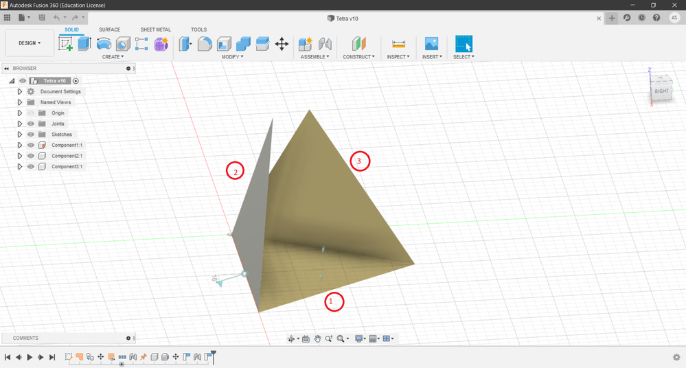

How to connect triangles (surfaces) for tetrahedron?
Sketch -> triangle.
3 surfaces (components)
First - ground.
Second and third - joint (rotation).
How to glue 2 and 3 surfaces together?

Because 3D angle consists of several faces (triangle, square, pentagon, hexagon, octagon, decagon, and star 5-, 8- and 10-polygon).

1) I didn't find good decisions in my previous post (when I had not read about surfaces).
2) This method I use in real models from paper. The next aim - to do a computer game for making all the 75 possible polyhedra.

There have been several threads where users have shown how to create a tetrahedron,
Attached is my solution.
Message 7 of 8
Interesting.
But I am looking for the universal way for all possible faces, not only for tetrahedron. Hence I don't know all the angles between the faces (60 degrees in our example). I am looking for free face rotation and edge connecting.
That does not exist.
Thus, the use of a branch o math called trigonometry is strongly encouraged.
Unless you rotate the face to the price angle you cannot "connect" the edge. As I've mentioned already, that technique is imprecise and unlikely to succeed.
