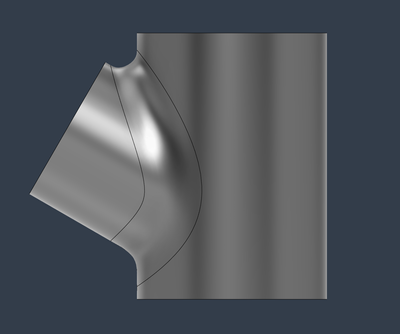

I'm trying to create my own T-pipe style object like in first attached image (created by someone else in Solidworks). The two cylinders are blended together in a very organic way.
I tried intersecting and joining two cylinders in the Design Workspace ("Solid" tab) and adding a fillet, but as expected, the result is nothing at all similar to the organic nature of the first attachment.
I'm not familiar with using the Surface or Mesh tabs, and am hoping there's a way to achieve this with a parametric design instead via the "Solid" tab instead? And if not, could someone please help me understand how to achieve this?

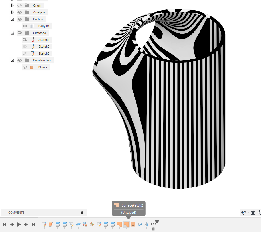

Message 2 of 18
davebYYPCU
No idea of the ratio between the pipe diameters, so you may pick up some clues.
Much easier with Surface, solids will be difficult due to solid Loft being limited quasi "four sided" objects
The Patch in this example is 5 sided.
Might help...

  • Rather than creating intersecting solid cylinders and trying to blend them together with fillets or lofts, you need to create surfaces of some of the key fixed elements such that you can patch their edges. The patching operation will automatically create the organic blend between them.
  • Rather than working on the entire shape, it makes sense to work on just a quarter at a time until you have created half of the full structure.
  • Stitch it all together so you have a single surface that represents half of the object you want. Then mirror it so you have the full body.
  • Use the thicken operation to turn it into the solid body that you want.

Hi! There are multiple ways to do it as Dave already illustrated. Here is another solution. Instead of creating a Fillet, create a Chamfer. Then delete the chamfered face. Cover the face with a Loft surface. The blend will be much closer to weld beads. Another way is to create a Chord Length Fillet (not the Constant Radius Fillet).

For full context: A designer helped me design the original T-Pipe design as the outer plastic shell for a prototype I'm trying to design. Unfortunately, the designer...
  • (A) forgot to have the protruding branch be tilted 5 degrees upward compared to the ground (e.g. XY plane). In their design, the protruding T is parallel to the ground.
  • (B) I'm now working with a DFM engineer to try to turn it into something moldable, but we're struggling to modify the original design.
I don't have access to that designer anymore, so I can't ask them to fix the design, but even if they do, it seems they had a lot of artifacts which caused issues anyway.
I've attached:
  • Original STEP file from designer
  • F3D file of my attempt to recreate designer's STEP file using @davebYYPCU 's instructions
  • Image that shows a comparison of the original designer's file, my attempt, and a request from my DFM engineer that I am struggling to fulfill.
If you have any thoughts on how I could solve this, I would be very grateful!

davebYYPCU
Having fixed my earlier deficiencies,
Makes sweet work when the sketches are fully defined. (no guessing) Slightly different set up.
I did encounter problems with the sketch 4 rail, and near coincident with Combine, so went with Boundary Fill.
Check and let me know if I have missed anything.
Might help...
