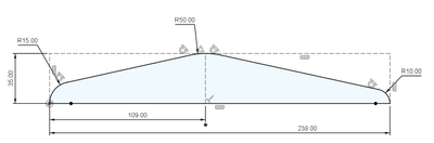

I'm having trouble modelling what should be a simple shape. It's a 2D diamond shape with rounded edges - but to an exact set of dimensions. The length needs to be 238mm and the width 70mm. The right end is also slightly smaller (narrow) than the left end.
Now in the file attached (Vent_Help v1)- I can get my edges rounded to the shape I am happy with, using the fillet tool on the extruded body. But the issue is that the dimensions are then less than required - as the fillet removes parts of the body to create the rounded edge.
I have tried experimenting with splines and tangents in the sketch (Vent v8), to try and get the rounded edges while keeping dimensions, however I'm either; unable to get a round edge, unable round the wider edges, or the tangent starts doing silly shapes.
Can someone please tell me where I am going wrong - and how I get the desired shape?

Why not start like this:Screenshot 2025-10-31 141119.jpg
PS. I need to add another radius..Gimme 10
Edit: This is better I think:

I created Construction lines perpendicular to the long axis....One at either end then a third horizontal at the top and a 4th to equalise the top 50mm radiusScreenshot 2025-10-31 143145.jpg

I think it may be a bit mouse control...which at times can be difficult to spot. In your case you appear to have more arcs and lines than needed. There only needs to be three arcs and two lines in this half profile. In my example, my 238mm Axis should also have been a construction line.
Edit: I had to check how I do it...I Start here:Screenshot 2025-10-31 150854.jpg
Then two tangent arcs approx the right arc length
Then I do the line an arc and a line in one smooth go
So from left to right: Arc...Line...Arc...line...arc...No more

I'm also unsure where you guys have clicked to create these arcs and lines. The file @TheCADWhisperer has uploaded has the correct geometry, but I'd like to cement my understanding of how this actually works.
Firstly, for the life of me I cannot get the tangent arc tool to work. Then randomly it does start working. But only when I have a second point to latch onto and a the middle line (going towards the top centre) already drawn - meaning the arc is not always 15mm as in your responses. I'm not 100% sure if that's important.
Then, I have no idea how you've managed to get the top arc to work. I can add two lines and make an arc between them. If it doesn't make a huge circle it will create the arc shape I need - but then because I've just had to guess where to place the two lines, I do not get the required width dimension of 35mm. I can start from the top centre and create 2 arcs of 25mm each, then create lines that attach the back to the outer arcs - but then I have to delete and recreate those arcs as they are not a smooth connection anymore.

1. The tangent arc tool in @Warmingup1953 ´ post refers to a vertical construction line.
However, this is not necessary if you use the center point arc tool, as I did in the screencast.
2. Here is a deliberately rustic way to create a sketch in less than 2 minutes.
