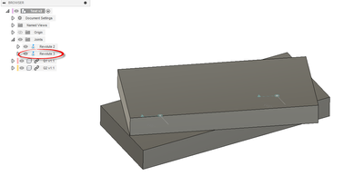

It seems that it is not possible to use two joints between two components!?
How do I then the best way mount two pins together? See supplemented file.

I think you are using the wrong type of Joint.
See attachment.

You just have to ignore the warning when creating the 2nd revolute joint.

Set the first Revolve to be 110 degrees offset.  The plate can also still revolve to other angles,
Two joints can be done with the ignore warning, but those 2 joints will lock the assemble solid.

What is needed is a Point-Line Joint (doesn't exist yet in Fusion 360).
In the real world we cannot manufacture perfect parts.
So in the real world there would also be a bit of twisting in the Revolution Joint.
If Fusion ever adds Dynamic Simulation functionality this condition of avoiding overconstrained Joint conditions becomes a challenging endeavor.
In Autodesk Inventor Professional - Dynamic Simulation Environment this would be accomplished with a Point-Line Joint as the second Joint.  It becomes a quite involved discussion - but the logic is fairly simple.
