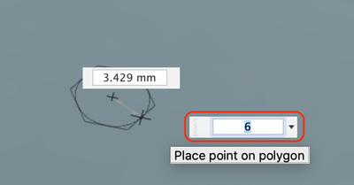

TrippyLighting
I can enter the number of sides on my macOS version of Fusion 360:
However, once the polygon is created the number of sides is not editable and there is no parameter for it. This has always been the case. Unfortunately!
