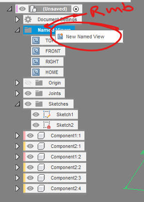

Edward3UXL8
I might be able to help.
When you are in the animation tab, orient the view to as you want it. Then, jump back to the design tab but don't move the camera! The view in the design tab will be exactly as you left it in the animation tab. Now in the design tab, you can create a New Named View. At the top of the explorer, right click 'Named Views' then 'New Named View'. This will create a new entry in the Named Views list.
After the Named View has been created, create a new 2D drawing. Insert a base view of the storyboard, then go to the dropdown for 'Orientation' in the view settings window. The newly created Named View will be in this list.The view in the 2D drawing will now be the same as the view in the Animation tab.
I've recorded a video to demonstrate this - See below
