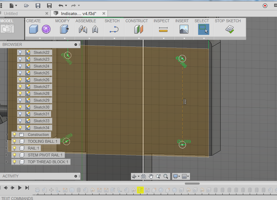

I have a an assembly that I have been working on for quite a few weeks now.
I have realized an issue with starting and stopping on a project like this is... I didn't keep track of exactly where I left off.
And now that I am modeling other components to build the assembly I have some threaded holes that are not in the right place and some countersink holes in a new component are not lining up with the threaded holes I made a while back ago. When I try and re demension them it tells me it is over constrained.
I havent the foggiest idea how to fix the original threaded holes to the right location.
Can anyone help me with this?
By the way when I pull up the sketch it does not show the demensions that are over constraining the sketch when I try and fix it.
I thought just deleting the demension would do it but I can't see any demensions.

Jon was kind enough to share his model, and let me post the results, in case others can benefit.
I was able to modify these holes.  Doing so revealed a few workflow weaknesses in Fusion :smileyhappy:
First, I had to find which sketch to modify!

so, now I know that Sketch34 is the one I am interested in.  But, unfortunately (this is another thing that needs to be changed), you have to first turn on the visibility of the sketch folder:
now, finally, we can edit the sketch.  This is pretty straightforward.  I added a vertical construction line between these circles, to keep them aligned:
Then, just add a dimension between the construction line and the right side:
and exit the sketch.  The holes are now repositioned:
Finally, the warnings on this extrude bother me.  I think that's a bug.  But, to fix it, I just changed the type of the extrude to "distance":
I apologize for the length of the response, and if any of it is overly obvious.
The 3 items I was able to distill from this exercise:
1. there is a bug with that Extrude - I'm not sure why it is showing warnings.
2. Fusion needs a way to select a feature and edit the sketch for it, without having to search around for that sketch manually
3. Edit sketch already makes the sketch you are editing visible, but does not check that the sketch container is visible.  In this case, I was able to edit the sketch, but did not see anything, because the folder was set to "off".
There are probably more...
Jeff

JonSchaeffer
Jeff thanks for leaving the original model for me to do this myself.
I was hoping you were not just going to fix it for me.
It worked great.
