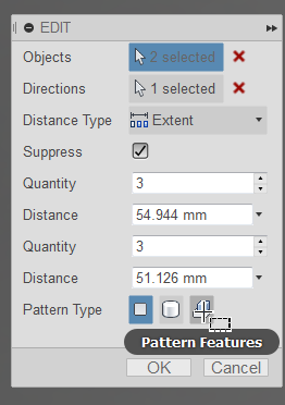

3. I was able to reproduce the third issue.  I'll file that bug.  However, there is a way to get the pattern to work like you want.  It is a bit subtle.  In your screencast, you have "Pattern Faces" selected as the pattern type.  This should work, I believe.  But, what I think you really want is "Pattern Features".  Face patterns are an optimized pattern compute that just copy the selected faces around, then join them into the body.  It is fast, but sometimes behaves differently than might be expected.  Feature pattern actually reproduces the feature recipe for each instance.  I tried it in this case, and it worked OK:

I also tried to create that pattern using "Patern Featuers" as you suggested, but as can be seen in the screencast this did not work. If it worked for you, could you create a quick screencas showing what workflow you followed ?
