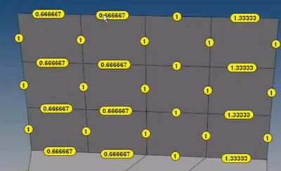

@PhilProcarioJr I was under the impression that "make uniform" command resolves surface tension, no?
And just for clarity, by surface tension you mean the "invisible" edge weights? as in opposite sides equaling 1 as in attached pic?

"I was under the impression that "make uniform" command resolves surface tension, no?"
No, at best it will smooth out some kinks in the surface, but honestly it's junk...
Surface tension is the amount of edgeloops and their placement required to maintain the shape accurately, if you don't have enough the surface approximation will not match the scan model to many and you get kinks in the surface. I will try to put together more info when I have time. Surface Tension is next to impossible to handle manually thus the reason I mentioned the relax brush in Topogun as it calculates this for you and adjusts the edgeloops in the mesh for you.
I have yet to see a good video tutorial on T-Splines for use accurately as a CAD model. It can definitely be done but not the way the videos are showing.

TrippyLighting
What uniform does is it basically re-aligns the T-Spline handles. It does not always work, so a standard way to handle such situations is to actually export the control mesh from Fusion 360 and then re-import it as in that case Fusion 360 has to re-calculate the T-Spline handles from scratch.
Message 19 of 22
Thank you very much. But what format do I use to export it to retain this new surfaces? I think fusion can only import stl and obj files. Or am I wrong?
Message 20 of 22
TrippyLighting
.obj export is in form of quad meshes.
You need to make sure that you have disabled "Triangulate meshes" in the MESH preferences, otherwise Fusion 360 triangulates meshes on import.
