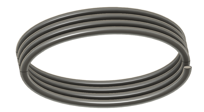

I would like to make a simple ellipse coil. One 'rotation"  so from the front view the ellipse looks normal, but from the top view it is extended like a coil spring.  The coil tool will not make an ellipse, what do I do?

 That gives me a circular coil of an ellipse section, and works well doing that, thanks! see the attached.  That is not what I am trying to accomplish.
I need a coiled ellipse with a circular section.  So instead of a circular coil in front view, it is an ellipse.
Message 4 of 18
Ok, I got what I wanted, i made the coil the height and length I wanted and then non uniform scaked it to an ellipse.  Thanks, I would not of figured it out with out your input!ellipse coil.JPG

Surface Sweep a line for one turn (360 - twist angle)
Extrude the ellipse (> Intersect) to trim the coil to plan form ellipse.
Add Pipe to elliptical edge of the surface.
Might help.....

Please in attachment the file ... as you will notice, the section of the coil must be oval. not the one of the wire.
Message 17 of 18
HughesTooling
@tormy.vancool I did answer to your other post but here's the file using your specifications. It shouldn't be too distorted as the pitch is shallower then in my other try.

Step 1, Draw a vertical centre line (Path - black) Draw a horizontal line, (Profile - blue) on Front plane.
Sizes that suit you.
Step 2 Surface > Create > Sweep the blue line around / up the black line.  Circular for now.
step 3 Hide your work.  New Sketch draw your ellipse on base plane.
Step 4 Unhide the Sweep body, Solid > Extrude the Ellipse set the operations to Intersect.
(will cut the outside area of the sweep body away.)  Set to Cut, will cut the inside away, won't matter for next steps.
Intersected - looks like this.
Step 5 Add the Solid > Create > Pipe, > circular > size to suit. Select the edge of the elliptical coil.
Hide / Remove the surface body
Might help.....
