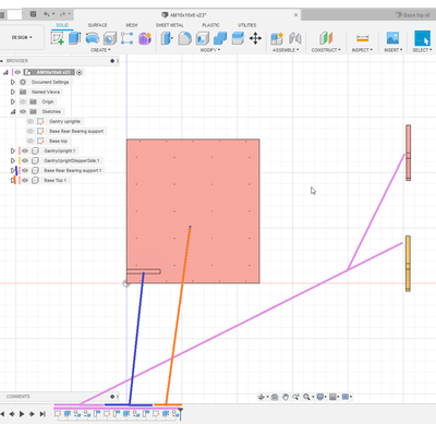

Each time I create a component I get the same color. Also the timeline seems to be using a different color.

In the videos I watched, every time they create a new component it's a different color, and the time line has the corresponding colors over it. I did make 2 bodies/components from the same sketch and those are different colors.
I have "Component color swatch" checked (it is greyed out)
I have clicked on "component color cycling toggle", but all it does is shut of the unique colors
The color bar over the timeline also a different color than all of my components.
How do I make the colors like in the tutorial videos?
Here is a picture of what I see with some lines drawn on to represent what I want to see:

@tjtalma wrote:
This no longer works. It is now creating a body as part of the componet. How do I fix this and make the current coponents that  are bodies into components without losing their timeline?
Of course it creates body in a component and it's how should it be. Body is the 3D geometry you create, Component is a way of organizing bodies. Check here for details. Also I suggest watching Self-paced Learning courses to getting familiarized with the basic concepts of Fusion 360.
Now to your question: From your screencast there reason you see the color bars in Timeline and Browser but not colored components is that you have only enabled Component Color Swatch:
But for the components themselves to be colored in the viewport you should also toggle the Component Color Cycling on. I believe @jhackney1972 already showed you this in his screencast, so it might be that you overlooked the fact that it's a toggle; so if you do it twice it turn back to what it was:
