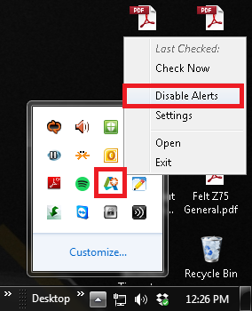

Can you take a screenshot of the notification to download Fusion 360? It sounds like the application that may be doing this is called the Autodesk Application Manager. The Autodesk Application Manager updates all of the software included in an Autodesk suite (e.g. Produce Design Suite).
If it is the Autodesk Application Manager, you can right click on the icon in the system tray and select Disable Alerts.

The blue circle is the Application Manager.  The red circle is what creates the Install Fusion 360 notification.  They are different applications.
