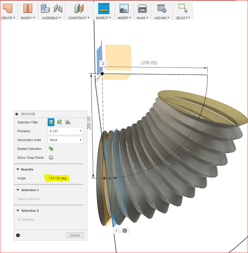

Success, well sort of. I created the curved part in a simular fashion to your screen cast, in metric, with the sizes I need.
It was a bit of trial and error getting it right. The only thing that is still problematic is the joins of each ridge, at the bottom:
This is going to be 3d printed so I need to know how to get those joins neat but also filleted.
The other thing is the insides needs to be a cylinder not the zig zag of the outside, like inside of the straight arm. That's probably a problem for later, but I am not sure how to introduce that, whether that  should have been part of the sketches.
Help is needed as usual.

The way I got the seams to line up was as follows:
1. I made the arc 45deg.
2. I inserted the Plane-on-a-Paths at positions 1, 0.95 and 0.9. Those three planes represent a single rib. The rib will occupy 1/10th of that 45deg arc.
3. I made the Circular Pattern 45deg and quantity 11. Now, that will add an extra rib beyond the end of the arc, but defines the end of the 10th rib at the end of the arc properly. You can suppress that 11th rib instance if you like.
So the math has to work out such that the division are known and can be patterned accurately. If this is done properly, the edges of the ribs will line up perfectly. If not, well, you get something like your picture.
I'm surprised your brain hasn't figured out that if you want a smooth inside, the easiest way is to make it at the same time. Or instead, Sweep a circle along the arc either before or after you do the ribs. Although I must admit, I'm confused by this requirement. Real-life ribbed, flexible hoses and fittings and pipes and stuff like that don't have a smooth interior. If they did, it would defeat the purpose of the accordion design.

Filleting the peaks and/or valleys is not going to look right. If you want curves instead of sharp transitions, I suggest you change the loft profile conditions to Direction instead of Connected.
Message 10 of 27
chrisplyler
Here I've set each profile to Direction instead of Connected, and set the Takeoff Weight of EACH profile (in each loft, so I did it four times) to 1.25 instead of 1.00. This gives a pretty natural looking result.

You will need to decide which bit to fix, seems like the pattern of 11 spaces, for 66 degrees, equals 6 degrees.
The second plane on a path is 5.865 degrees. It should be 6 degrees too?
You did not notice that your maths would have included the length of both lines?
You could change the pattern to 64.515 degrees but the thicken as it is, will overlap the other way.
I think you had two more problems that contributed, you did not stitch the two lofts together to make one body.
You then thickened them and the result was 1 body from two Patch bodies.  Patterning those by the overall angle error as above.
Pattern the surface bodies, and stitch them to one body, then thicken.  This workflow works as expected.
Still doesn't give the directional Loft as Chris demoed, but that is as desired.
Tsplines avoided all this.
Might help.....

I am being specific with what I don't understand.
You mentioned that I need to make the angle 6 degrees. You have the edit feature, which only shows the distance as 0.398197. Is that meant to be related to the angle, and if so how do I interpret it. This is what has me stumped. I need the planes at specific angles, but I don't know how to put them there?
Regards
Ian
