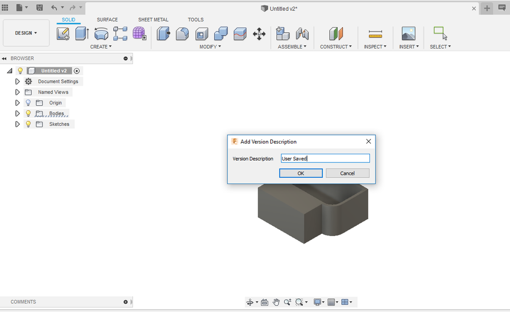

While it is often great that old revisions are saved, there are many times that I want to save a drawing without creating a new revision.  Right now I am working on a large model and creating drawings of different views of it.  I have a dozen different drawing views open and save them just so they can be named something different than "untitled" then I look back at them and realize that a note I have been adding was missed on one, I add a dimension on another, etc., etc., and now I have a set of drawings all with different revision numbers and I really don't want to save the old revisions.  So is there a way to do a save without it making a new revision?
ng save which helps you to promote the w

Oh, I saw the answer on a video the other day. Ctrl+Shift+S, saves a local copy, no versioning.

This is by far the stupidest "feature" of Fusion 360. Shift+Ctrl+S may save something, but in many cases that something is of zero use. Every time I make a change to my design I have to actually create a new version just so the change propagates to the 2D drawing. I have a very simple design that's already at v44 and it's all just a bunch of pointless versions that just create clutter. Out of 44 versions, a mere 2 bloody versions are actually intentional and purposeful. Often I end up just duplicating the whole design because it's easier to work that way, as I can have both the old and the new design open side-by-side, and I don't need to wade through a dispassionate list of versions named "User Saved". Meh. The way you have implemented version control is utter garbage.
In addition, Shift+Ctrl+S doesn't provide any visual feedback that the save has been successful = Ufail.
Autodesk please do this right and add proper local save plus an additional "commit" action to save a version.
