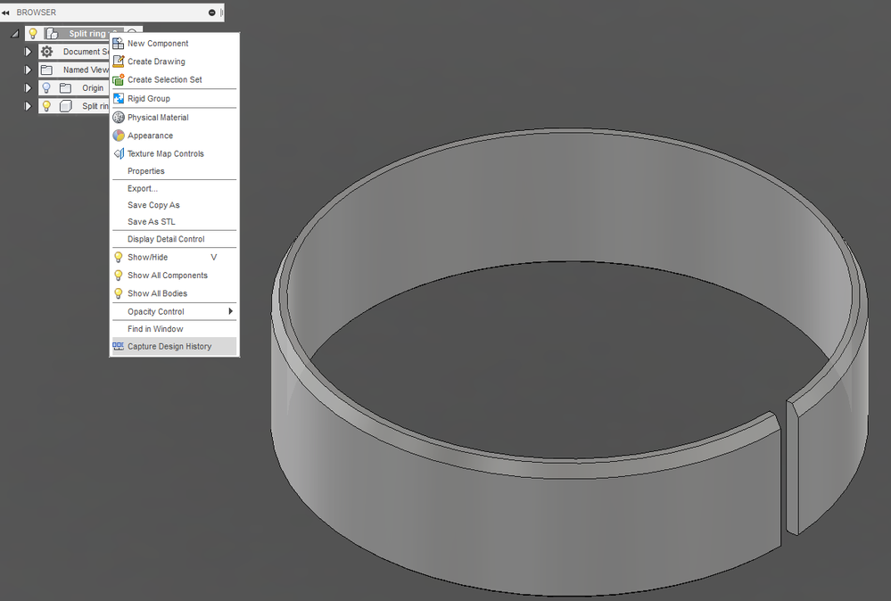

Is sheet metal still not available? It still doesn't show up in the menu it claims to be in the tutorial video here  https://f360ap.autodesk.com/courses/sheet-metal/lessons/creating-a-sheet-metal-component, my menu only lists "Sculpt, Model, Patch, Mesh, Render, Animation, Simulation, Manufacture, and Drawing", but has no entry for Sheet Metal?? How can I access the Sheet Metal Tool? I have Fusion360 version 2.0.5511.
Message 51 of 53
daniel_lyall
turn capture design history back on

CLmoss
What is all this?
My menu still shows Sheet Metal.
Where is the capture design history option at?
Jim
