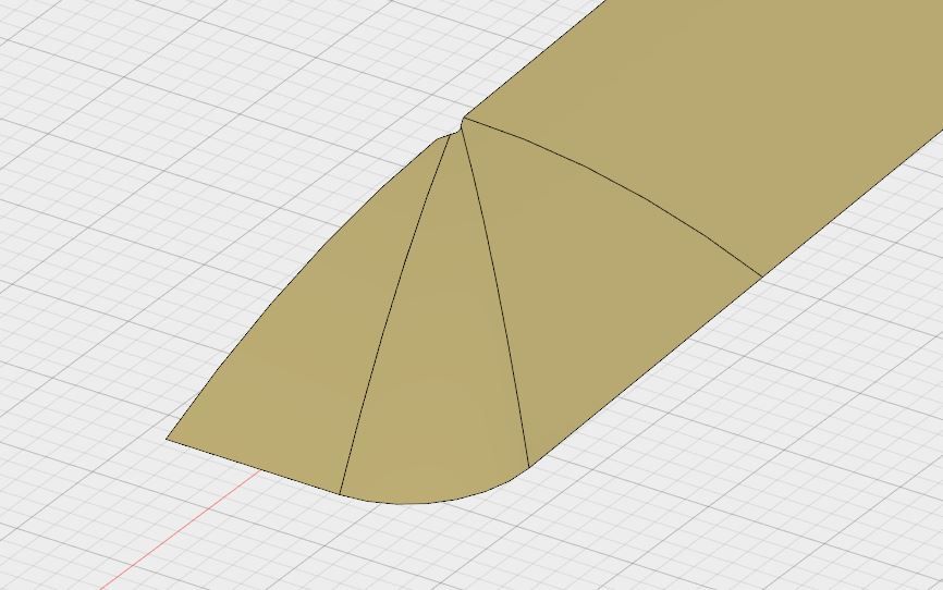

So, I've tried a few approaches from the Guitar Body thread. One approach that I think could work is a lofted surface. I've gotten a surface shape that I'm really happy with, but I am unable to split the solid body with it for some reason. Here's what I've done:
First I drew all my sections. I wanted to make them all connected at the same center point, like in this example, but I wasn't able to get that to work. So instead I just spread them out a little and then patched the small hole. Perhaps my problem stems from this?
So I was really happy that I got to the shape I wanted. Then I extended the surface to protrude beyond the edges of the body and attempted to do a split body operation, but it is unable to "combine the geometry". It suggests checking inputs with the Validate Tool but it does not appear in the Inspect menu anyway. Plus I thought it was mainly for imported geometry?
Any ideas why the split body operation is failing? I'm thinking of trying to just build the whole thing out of surfaces and then stitch it all together and turn it into a solid if I can't get this to work.

jeff_strater
Thanks, Bryce, for posting the model.
We will take a look at it.  However, my guess is that you are right -  the problems are with this patch where all the lofts meet:

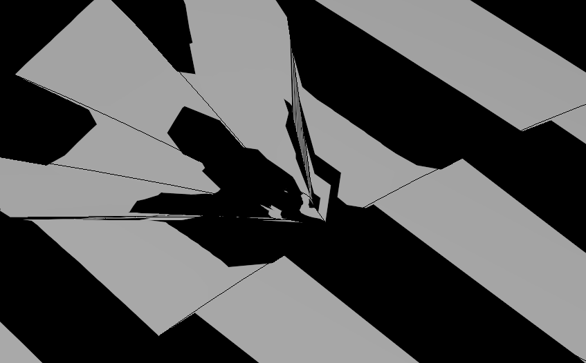

You can kind of see, just from the model shading, that something is not quite right here.  But, if you turn on zebra stripes, you can really see that this is not kosher:
There are a lot of strange continuities here.  I still think that Split Body should work here, and the fact that it doesn't is a bug.  But, you can probably make life simpler for yourself (and the Fusion modeler) if you make this surface as a single loft, or maybe several lofts, but that meet without needing a patch.  Patch is a nice tool, but it sometimes generates wonky geometry that can affect downstream operations.

I actually also noticed the strangeness happening at the patch after making my previous post as well. I was looking at it with lines turned off and noticed the weird shading. It doesn't allow me to thicken the surface either, in fact it crashed Fusion. I really wanted to make it as one of fewer lofts, but wasn't able to get anything other than the broken up version I shared. I also noticed some of the loft surfaces are not tangent, but the loft errors if I turn on Tangent or Smooth.

Thanks, Bryce, for sharing this model.  It revealed a bug in our application logic that had not been discovered before.  I'll spare the gory details, but suffice it to say we were doing some unnecessary processing, and this is where the "problem combining geometry together" error comes from.  We didn't even make it to the split!  So, we will fix this bug, of course.  This case should succeed.
Having said that, I do think that you would be more pleased with the results if you can come up with a single loft to describe your dividing surface (or a TSpline surface).  The continuity of either of those surfaces are likely to be much higher than with one stitched together.
