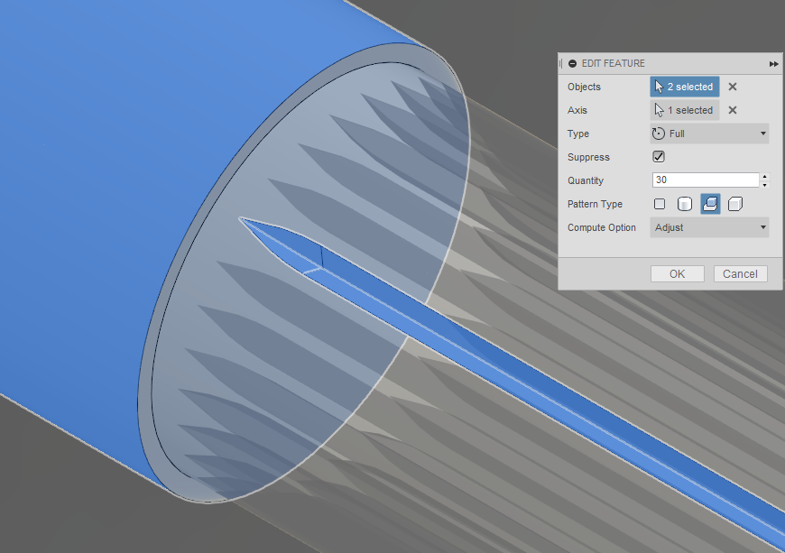

Sorry about that.
Mark is on the right track with the first post, but I can't figure out how to incorporate that in my current model.
The area highlighted in blue needs to have longitudinal v grooves along the long axis that wrap radially around just like your first post shows. It's grooved for gripping.

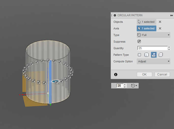

JamieGilchrist
Like this?  I'll post the Fusion model so you can see how I built this.
 Edit:  attached my model that essentially follows Marks workflow.  Hope this helps.

What I'd do is create a plane where you want the splines to start.
Draw the profile of the grove on that plane. Then extrude cut
Then make a cicular array, for pattern type select Faeture and select the extrusion from the time line. For axis select one of the other round parts set the number of copies then OK.
Example file attached.

Thank you both!  That's exactly what I needed.

HughesTooling
Just another tip on Circlar array, you can select more than one feature if you need to. You can make your splines look more realistic if you plend the end out as if thay where milled like this.
File attached.
