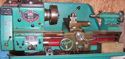

Oh for a lathe indeed!!. I had a Willson slant-bed  lathe in the mid to late '80's when I lived with my parents. It had an 18" swing so I could turn some pretty big stuff with it. It was this that enabled me to get my first job in engineering. Unfortunately I had to sell it in 1989 and I haven't had the space for another one since ☹️
I've found a photo of what looks like the same model as the one I had on the interwebs:
If I think of any other options I'll let you know, and don't forget to keep us updated with your progress or if you need any more help.
