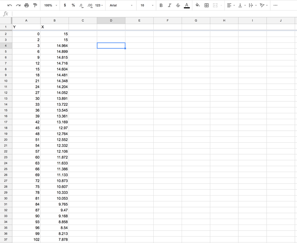

I am new to Fusion 360 but have been slowly learning different techniques.  It's great.  My next objective is to find out how to create more complicated conical shapes such as rocket nosecones that have different characteristics.  I'd like to start by making a nose cone with Von Karman profile.  Can anyone help get me started with this?  I can easily make a simple cone but that is about as far as I have been.
Thanks in advance!

I'm having a difficult time just cutting and pasting the formula but here it is in picture form:  I would like a VK series so we would use C=O, R=15 and L=150. Does this help?  Thanks so much for the help!

Here is where I am with the Sheeter addin.  Not very far at all!  I have the coordinates for 1/2 of the 2D nose cone.  I am hoping to get a sketch using those and then revolve.  @prainsberry do you have any suggestions on where to go from here?  Thanks in advance.

I think they do NOW.  The resolution isn't quite what I want but should work for this experiment.

I think that you might find that fewer points return better curve than more points.
Can you zip and attach your spreadsheet here - I would like to experiment a bit, but not motivated enough to build it (the spreadsheet) myself.

Hey actually i don't think this is a good use case for Sheeter.  There is a script that will import XY coordinates and fit a spline.  I believe it is in the app store.

ImportSplineCSV is supplied with Fusion, just click Add-Ins on the toolbar. I think it needs XYZ coordinates so just add a column of zeros.

Eureka!  That did it.  For some reason I had to divide all my values by 10 to get it to scale and import correctly but we made some progress there!  I used the ImportSplineCSV to get my main spline line and then built the inner line to spec or close enough and then just used revolve.  Awesome!  Thank you!
