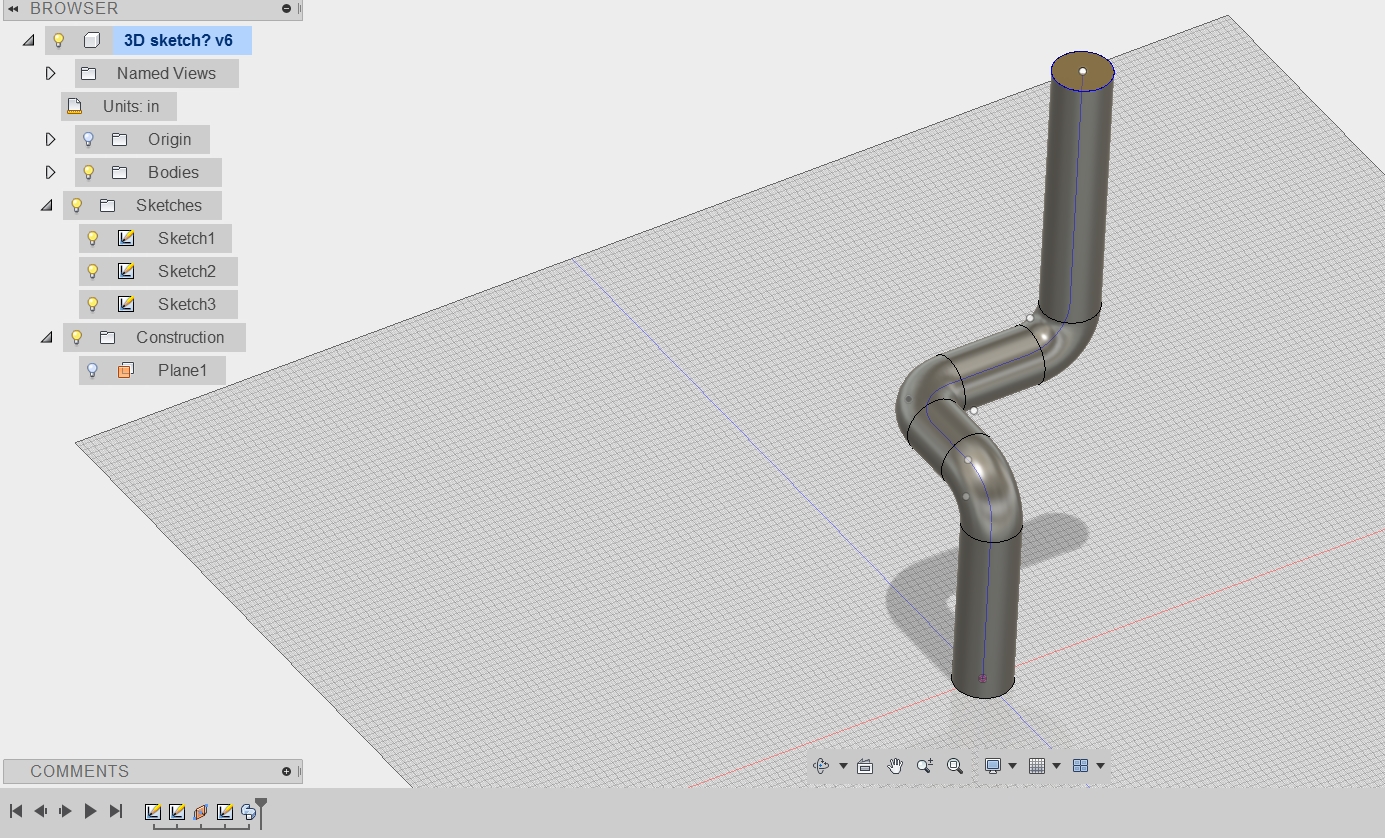

I understand there is no 3D sketch mode.  I am used to Geomagic Design where you can change planes within the same sketch.  Below I am trying to join the two sketch pieces with a fillet so the loft has no sharp bends.  I have tried the include 3d geometry command for the points but must be missing something.  Is there a good workflow to create something like this?

Hi, one way is to use the sketch fillet tool, but both line segments need to be in the same sketch.  A quick way to accomplish that with what you already have, is in the sketch with one of the lines, use Include 3D geometry tool and click on line in other sketch, which will create purple duplicate line in current sketch.  You can then turn off visibility of other sketch, and do window/box select of everything, right click and choose Break Link, which will turn the purple "projected" line to regular color, after which should be able to select it and other line in same sketch to fillet.
Another great option is to fillet as much as possible after sketching, using the Modify > Fillet that will then show up in timeline.

Accomplished it with the first method.  Good solution--Ended a lot of frustration!  For something so simple for another program to do, it seems like a lot of work though.  Can you please elaborate on the second method.3D sketch Complete.jpg

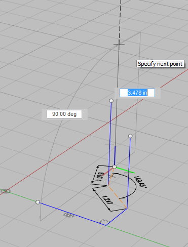

Cool!  Also you can quickly create 3d lines (i.e. off the sketch plane) in the same sketch by various methods.  For example, if you tilt your view at somewhat of a low angle, then try making a line from a point, should get this triad as shown below, which allows to draw the line in 3D directly:
The method I'm using above is to create reference geometry in the sketch plane to then make 3D vertical lines from, since trying to control angles and dimensions in 3D directly is more difficult.  I then made most of the vertical lines construction geometry and connected their 3D end points.
You can also use the move tool to move existing sketch lines and points off plane.

BTW, it can be a little tricky getting used to having that triad appear.  You first click to start a line on some point on the sketch, then start moving your cursor upwards, perhaps quite high before the triad should appear.

Very quickly made this with the 'triad' method.  I expected to be able to go back & edit the sketch & dimension the lines, but can't add dimensions.  Can't select any curves.

Glad to hear you got the triad working well (I found can be tricky to get to appear when starting from sketch plane, seems to be better to start at some point along a sketch line rather than line endpoint).
There appears to be a trick to enable dimensioning 3d lines.  Once start 3D line (clicked its first point), will have option to directly enter a length value, and then an angle.  Be sure to directly enter a custom length value, and hit enter (3 times I think).  Then you should have the length and angle automatically dimensioned, which can then be clicked on to change the length and angle if desired.

I found the trick to getting the triad to appear, after tilting the plane, is to get the angle to snap to the 90.0 deg with the dashed line.  I did originally get the straight lines dimensioned as you said, but when I put the fillets in, dimensions disappeared.
